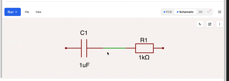

Viewing Symbol Ports​
To visualize the port positions on your schematic symbols, go to View > Schematic > Show Schematic Ports in the editor:
Show schematic ports option in the View menu
